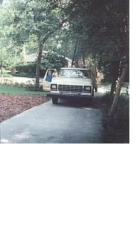

In my younger days I worked full time for a paycheck, benifits, etc. and also worked for myself after work and on weekends. I had a custom built 18' flatbed trailer ($2300) and a 1-ton boom truck that I picked up from a landscape outfit for $700 and rebuilt from the ground up(about $6000). With one other person, I was knocking out $800-$1000 removals on a saturday and it worked fine for a young man with more stamina than I have now. The boom/ winch would lift more than the truck weighed so I could load anything that didn't pick the front tires off the ground. The trailer crossed the scales at the dump carrying in excess of 20K lbs many times.
I'll attach a picture of the truck if I can dig one up.

This is the truck shortly after I bought it, still under construction. You can see the boom and winch setup better.
