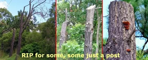

Thanks and TD same. I'll age with pics of these doing their thing. I've not really seen this before at that height on a species like that.
Here's a pic of what happened to some of them.

Yeah they'll die when they lose too much food. That's why I see excessive raising as part of the same evil as excessive reduction.
Re: Topped or drop Crotched? And what\'s the future
yeah . . . what you expect when you remove 50% or more of the money making end. Now do you think they learned anything? will the same foreman come back? was the foreman/whoever limited so he couldn't remove the trees originaly? did a nearby homeowner get involved?
