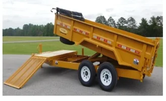

Does anyone have experience with a trailer set up like this? Do you see an issue with tongue weight if you were to have a 2800-3500lb machine on 4’ deck. The manufacture states it’s designed around a MT55

What are we talking about.. a 4ft deck in a small trailer like this? Most max tongue weights on those small trailers that I've seen are like 200-500lbs...
But we're talking something like this..

I had posted a picture. Don’t know where it went, but this set up

There ya go.. i think you got it.. haha..
Yeah! Right on..! That's pretty freaking cool man! I've never seen one..
Downside? Chyeah.. id say your loading that tongue pretty good if the trailer is loaded as well. However.. if it's legit it's legit..
Is the rating not lised on there? Or on a manufacturer's site? Id imagine if the manufacturer designed to carry a load like that, it fine.. that is unlesz your trying to go bigger than what that MT55 weighs..do they really weigh 2800-3000k?
But if its legit.. Id be more concerned about the truck side & what classes hitch your running & whether or not you have bags in they're to help level the load for a stable driving characteristics. You can always adjust the trailer side pintle ring up or down as needed to level the trailer.. but you probably already know that..
Hahaha.. "are we talking about something like this" i seriously thought you were relating to front loading a little dingy trailer with that much weight.. i was like ahhhh yeah.. this isn't gunna end well..

If it’s a issue you can put the mini in the dump on the way to the job, and then when loaded up on the tounge for the ride home?
That was kind of where my thoughts were. Or a grinder like the SC40TX on the front and a mini in the trailer possible spun sideways. Just trying to find an efficient system while sticking with the truck I have.
Well what are you driving..? I assumed you were driving at least a 3/4. If u already are, what would you go up to? I mentioned air bags earlier, but those will be useless if you can't stop or drive without the trailer throwing you around because the truck is only a 1/2 ton. & that's not even taking pulling power into consideration..
Like the other post shows.. he could tug around that trailer with that frontier, but as soon as your talking steel & adding solid dump style sides, hydraulics, heavier frame & way more steel there's no way it will be able to safley pull it..
Shit.. i got a smaller 8 x 14 16k twin piston & when i first got it, everyone wanted to borrow it, most had 1/2 tons & all claimed they could tug it no problem.. Long story short, it sagged their 1/2 ton so bad they got stuck on a hill bottoming the hitch out, ripped my emergency cable, buggered up the jack stand & even after all that, dragged my 7way cable till it was a 3way cable.. Then once they filled it i had to come out to pick it up cuz they couldn't pull it. That was the last time i let anyone with a half ton borrow it.. i also started charging ppl to use it.. once i did that, no one wanted to "borrow" it anymore...

yep exactly, thats why a snowmobile is in that trailer, or maybe a zero turn lawn mower? But honestly, if you only want one truck for chips and hauling a chipper, at the minimum it needs to be a 1 ton with duellys. With overloads and a dump box! And even at that don't expect to pull much more than a 6" chipper with a load of chips on board! That wont leave much room for crew and gear either! As for B training... Not legal here but if it were you would need a 2 1/2 ton or better to pull off the stopping power and best with air brakes!
Oh well yeah.. if he's trying to do a chip box & that trailer or chipper, then yeah..lol.. he'll probably want a dually..

Thank you sir. I think I’ve come to the conclusion that I’m going to look for a basic 14’ dump trailer and focus on equipping myself with more climbing and rigging gear this year and then possibly take a leap into equipment next year. Thanks for your time!
