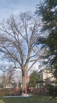

Thinning out a small 7" American elm. Fast but gratifying work. Especially after several days climbing and thinning a 50" pin oak tree on the same property. Before and after pictures - almost done with the oak.
I most enjoy working for people who love their trees!
And after ...
Pin oak before ...
And now, almost done ...
