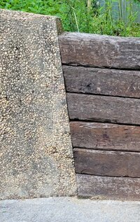

I'm replacing yet another crosstie retaining wall thingy for a friend. I like nice accurate chainsaw cuts, whether they're straight, miters or compound miters. Since it's difficult to mark crossties, I've been using white duct tape to mark the cut lines - use one edge of the tape to mark the cut line. It makes a good hi viz line which doesn't get obscured by the chips. Of course, tape doesn't really stick to crossties, but a few staples hold it in place nicely. I usually mark 3 sides, score each side, then cut through. I get better than 1/8" accuracy this way.
These are some compound miter cuts from an earlier project.
Anyone have a better method? I don't want to build anything elaborate for an infrequent task.
I always used a carpenters pencil, I think I used a red one though, not a regular graphite pencil. If my memory is correct, the red showed up better.
