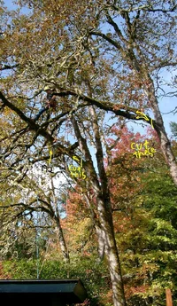

i bought one last month because i couldnt afford the 200T. Here is the first thing I did with it and it performed like a champ. Light and had enough power. Did bog down a couple times but im running a 16 inch bar and cutting stuff too big. Keep in mind that I did this in my spare time not for work, Im just a groundie, so dont criticise the work!
