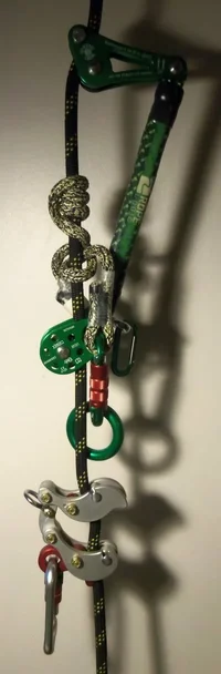

Ok, I apologize for going on about this critter... I'm a little buzzed up on caffeine (as in, full blown crackhead buzzed up) and admittedly a bit excited to play with this thing. On the KM-III Max (a rope I truly adore) I started with the same settings that I started with on the Cherry Bomb and it works absolutely beautifully. Might fiddle with the top adjustment for shits and giggles, but it feels real good where it is. Very responsive and smooth as butter. For me, this might be the rope for it. One more pic of the Akimbo and the Rope Wrench setup that I have been using with this rope. All the other ropes so far were new ones... this one has a little mileage on it. Note the huge difference in vertical space consumed by the two setups.

If I continue to harass you, my friend, it will be because you're a frickin' genius and I need you to stay humble so you keep exploiting every crazy idea you have. In spite of a lot of fears expressed that this might be another ho-hum mechanical, I think it just might be as close to perfection as anyone can reasonably expect. And, I've been playing with it some more with the KM-III Max rope. This is a 32-strand, 11.1mm line with a nylon core. But, it's very firm and the Akimbo loves it. I braved the dark, cold and wet and made about 30 trips up and down my whopping 4' of working height on the garage hook... wow. Just wow. I stuck it on an Aztec 11.7mm Yale line, and I thought it flattened out a bit too much and had more drag. For me, the KM-III Max is going to be it... I can tell already. Thanks for sticking with your pet project for so long, and seeing it through. I have no doubt that the RE version will be amazing.

Dude, this is one of my favorite things about using a mechanical for SRT. It's so compact. Really shows how nice the size is when your working a spar using a cinched anchor with a retrieval tail. Loooooove it!
I was hoping to try mine out on that orange Aztec... I've got a couple or three hanks of it... but weather turned nasty. Snowing again, tonight. Supposed to be 50*F on Monday, so only gotta wait awhile. I put it on a hank here in the house, but really can't tell much until I can get into a tree with it. Seems to flatten more than the KM Max, but it doesn't look like that will be an issue, from your pic. Thanks for posting that... :)
