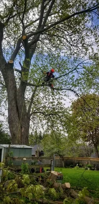

I shot this massive shot with the big shot into an adjacent pine in a crotch between two 5" leaders - how often do you get that? My throw line was 150', so I had to install my climbing line on a second shot in a lower crotch, pnw-style - my first time. After I ran my tail over the high TIP an *re-installed my midline attacheable Akimbo*, I traversed 30 feet over on the hook to the dead pine. Tip tied and launched a 30 foot top into the yard and road, then grcs-ed a second 30 foot top into the same spot, then grcs-ed a 20 foot section of trunk. The section had a 30 foot long horizontal limb that shot out atop the outside of a live oak crown, so it came over the top and landed in the yard. Here's a picture, Akimbo included:
59913
