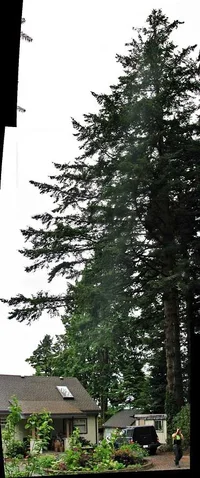

2 different times I went to this tree to take a few of the lower limbs off above the house. The first time, I rig off about the end third of the limb, lose my balance from the 'springboard effect' and end up below the limb hanging from my lanyard (it my not seem like it in the picture, but the lower limbs were about 40' long but only 10" diameter or so at the largest, hard to balance on out near the end at the best of times).
About a year later I go back to remove it entirely. As I rig up the end of the lowest limb I remember what happened the last time I was in the tree. So I suck up my lanyard nice and tight and brace myself as well as possible and where do I end up when I make the cut? Below the limb of course. I had a tie-in about a hundred feet above me there should be no excuse. Only my pride was a little injured.
