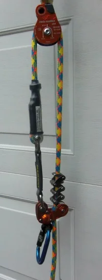

Smooth as glass in the ZigZag... grabs instantly, tends with no friction at all (full 1/2" lines have a bit of friction in the ZZ)... the ZZ is reliable with anything at or above 11.5mm and under 12.5mm but performs best the closer they are to 1/2" and this rope... just perfect. Only place at home I could play with it is only 20' up, but it's enough that I can tell I'm really going to like this one.
As others said, little bit of bounce (just right, for me) and a surprisingly good hand for a kernmantle rope. Very firm, doesn't flatten in the ZZ like the 11.7mm Yale doublebraid ropes. Tight cover, toothed ascenders work flawless on it. I'm going to have to try it with SRT, but that will have to wait until I'm done giving this setup some tree time.
