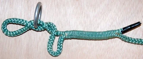

Just for giggles, I threw this splice together with the ring in place using some Ice Tail I have laying around.
You do the first locked Brummel 'exactly' as if without the ring. However, insert the ring for the second pass, then add a third Brummel with the short rope end BEFORE burying the end into the core.
Note: For reference, I intentionally left a larger loop in the last Brummel end as it passes into the core for final bury.
The only caveat: This works because the eye will be girth-hitched around the chainsaw. If not, the rope at the eye would be pulled through where the ring is when weighted.

I am not sure from the picture, but it looks to me like where you did your final bury, you need to add one more Brummel to 'lock' the ring. Take another look at the photo I posted and you will see there is one more pass.
-Michael
Yeah, I noticed it looked different. Did my first McDonald Brummel on that one.
So, I did the initial locking brummel (2 passes), then another with the ring, then a bury.
