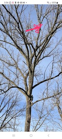

I read back through this thread and got some good tips. I tried the throw weight on the rope and the monkey fist today. I climbed branch by branch up a tulip poplar DRT/lanyard. It was a fun climb but, I wish the tree was bigger. It’s about 60-65 foot and top was getting too skinny. I also climbed my cottonwood the other day to about 50ft. I realized that it’s not strictly for fun but, I’m trying to challenge myself. My SRT TIP was at 55/60ft. The branch I’m on is at close to 50ft. If I swing around or climb the other side, I’ll get to the junction of multiple branches. You can get a sense of how big the tree is from the photo. What has me uneasy is that I’m 50ft up a massive tree, 15 to go and I don’t seem to have a place for my lanyard. I had a DRT on the back side of the tree even though I never weighted into it, other than on the ground. Basically, it acted as my lanyard. I did tend the slack but, 2 systems was a pain. It seems that my issue is not the height. I have ridden a crane over 120ft and climbed 70ft. I used 28ft ladders and manfifts my working career. If it feels safe…I don’t than issue with height…Yet! I know that I don’t have to climb and could give up but, the challenge is my motivator. I’m going to try again after the holidays. Craig
Honestly Craig you have another 50ft to go for a nice TIP. Will take time. Best part of climbing is moving to the tips. Screenshot_20231216_175841_WhatsApp.jpg
Honestly Craig you have another 50ft to go for a nice TIP. Will take time. Best part of climbing is moving to the tips. View attachment 91616
Made it to the last safe tie in tonight. Only took two years. I’ve been doing a lot of work climbing and more rec stuff. I helped at 5 comps last year and got numerous tips and tricks. I measured it at 90ft. This may be routine for some of y’all, but it was a satisfying accomplishment for me. I felt like the TIP was solid and tree not moving too much. If it was a hardwood or even a straight up conifer, I wouldn’t be uneasy before now. Thanks for the encouragement!
