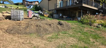

Tomorrow's stumps are pretty big with a large area being ground to remove exposed roots. It's about 90' up a hill to where a dump trailer can be parked.
To cut down on drive time up the hill, I'm thinking to load IBC totes. Fill a couple of them, switch to forks. Flip them in the trailer and then go back down the hill to fill them again.
In a test run, I can carry a tote with 5 buckets of dirt in it. Reducing my travel time by 5-ish (some time loss in switching attachments and flipping totes over) this should also reduce a loss of material while driving as the totes won't be filled to the brim due to weight.

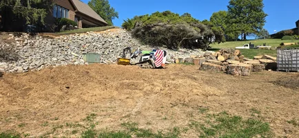

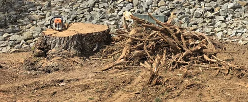

I thought I'd share pics of the stumps I did today. I'm really thinking the only way to be efficient on large stumps in open areas is a full size skidsteer/tractor which I do not have.
The top pic is a red Oak, somewhere around 36" where we felled it.
The 2nd pic is a roughly 42-48" siberian elm at the felling cut that had 20' of exposed roots all around it. The Oak alone filled a 16' dump trailer. As I pulled the pea gravel back from around the siberian elm, I noticed that the exposed roots pulled up pretty easily with a grapple rake. I was able to pull a lot of the roots to cut down on the amount of grinding. 20250930_140150.webp
The job went well enough, just always looking for what can make it go faster/ easier
