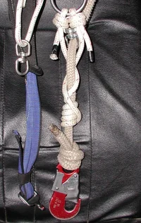

Using your D-ring as the slack tender will streamline your setup a lot. Working out the slack so that the tails are as short as possible makes for a compact setup. It also makes the slack tending action very smooth. I like the Distel for the adjuster because it is symmetric and the tails can be made really short.

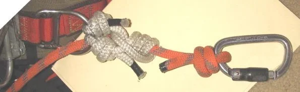

Here is my lanyard with a Vt tied directly to my D-ring.
Dan
