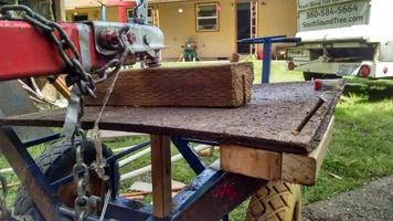

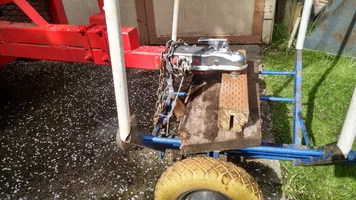

IMG_20170427_100657584_HDR.webp IMG_20170427_100907396.webp IMG_20170427_100907396.webp I'm thinking about a metal version of this basic concept for ball couplers. Weld a nut in place, swap to the right size ball as needed.
If like to go a step further and make it with hitch tube that will accept slugs instead, allowing a pintle hitch for my 4400 pound chipper that is useful to spin manually 180* at times.

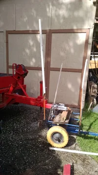

The axle will bear the load, stabilized by the basket.
P.S. the rear tube is at 6.6'of the ground. We load the basket, add PVC sleeve extensions, then as we get to the top of the pipe, we can slide the pipe up another 2'. Chainsaw wrap handles slide over the PVC, and gets held up and cushioned by brush. Rakes on top.

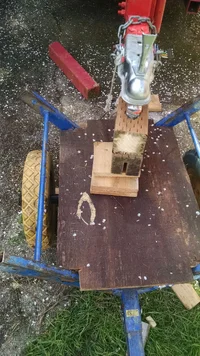

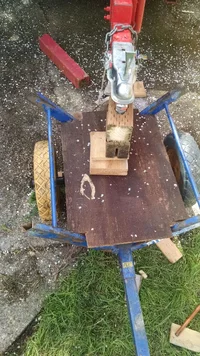

The last idea is simply a notched plywood tray, with a support beneath it. Riser boards will adjust the height. A metal baseplate welded to a nut that fits the shank of the tow ball. Screw in the right size tow ball. Through-bolts through the layers will hold it together.
Only out of pocket cost is a bit of welding, and the base plate.
