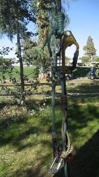

Anyone who has climbed on a system like this(SRT,FFC), do you find that the weight of your rope makes it harder to push up the ascender the higher you go? I experienced this and so tried taking it with via backpack. It helped, if you don't mind carrying the weight i guess.

RE your first photo (with the short prusik): I think you'll find that, once the climber has ascended some distance, there will be so much tension on the line that it will be hard to release that system. Look at the discusion here :
http://www.treebuzz.com/forum/showflat.p...=true#Post57009
that talks about using trunk wraps and a load releasing hitch. More discussion here:
http://www.treebuzz.com/forum/showflat.php?Cat=0&Number=91780&an=0&page=0#91780
using the same photo that started this thread.

Here's a few I've been playing with so far
This is how I like to attach my anchor line for a floating false crotch (ie Pulley). I've been using a Valdotain (no braids) with as many wraps as I can get with the eye/eye prussic, just because its an easy hitch to "tie."
I'll actually use the same biner attached to the eye/eye as a marlin spike in my stopper knot.

One small detail to consider...take a look at the way that your biner is clipped around the rope. If you clip it 'the other way' the gate will be shimmed just a little off the trunk reducing gate loading.
It's my preference to have at least 1.5 turns on the trunk before clipping the belay sling onto the upper rope. Two full turns is even better. By doing more turns the rope stays more fair and is less likely to slip up the trunk when lowering.
