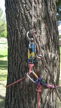

The Treemagineers showed me this belay anchor. I like it, it,s very simple, clean and fast with little equipment. It is also arbor and rescue freindly. A munter backed up by a half hitch plus a prusik. Very easy and fast. They used a hitch climber I only have one. So I used the CMI.Nice clean connecting points.

It's kinda like that. Mine Is a 25' 16 strand rope with a ring spliced in it. I like it because there is no caribiner on the tree and no knots to tie. Like a prusik adjusting rope guide the concept is the same except you need a rigging plate on the pulley. I really like it because it;s simlpe clean and fast. In the past I have used a sling and a gri gri. I also used the access line with wrapes and then tied off to it;s self. This anchor is also freindely to arbors and rescue personal. It seems to have many bennefits with little limitations? In my market a 200' access line will do the job 85% of the time so anchor works well for use.

Hey Tom, Just wondering why there is so much slack in the anchor. Why wouldn't you pull it tighter? Is is to reduce the bend radius, or maybe to assist in the release of the hitch in a rescue scenario?
It looks like it could slip
That isn't the best picture of the Trunk Belay.
A better setup would be to take another turn around the trunk before clipping the Belay Hitch.
On that particular setup there is a branch just out of the picture up to the left that acts as a catch so that the TB wouldn't roll up.
Good eye :)
Ok Thanks, I've seen it set up that way before and thought there might be a particular reason for it. Yeah, taking another turn would be solid. Just working on perfecting my SRT anchor today :)

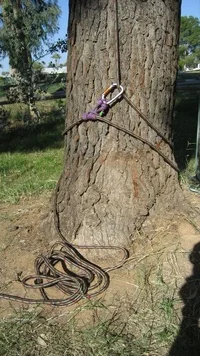

Here's a few I've been playing with so far

Here's another one. It's a few half hitches above a figure 8 backed up. A friend and I tested it out and it is easily belayable. Does it seem okay to you?
