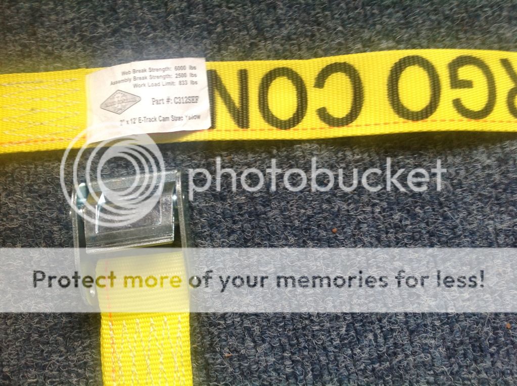

Well I've already got the cam wedge mechanism and 12 feet of 2 inch wide polyester webbing ordered, so the answers to those questions will soon be answered.
The cam mechanism is rated for 3K lbs, soI should be good there.

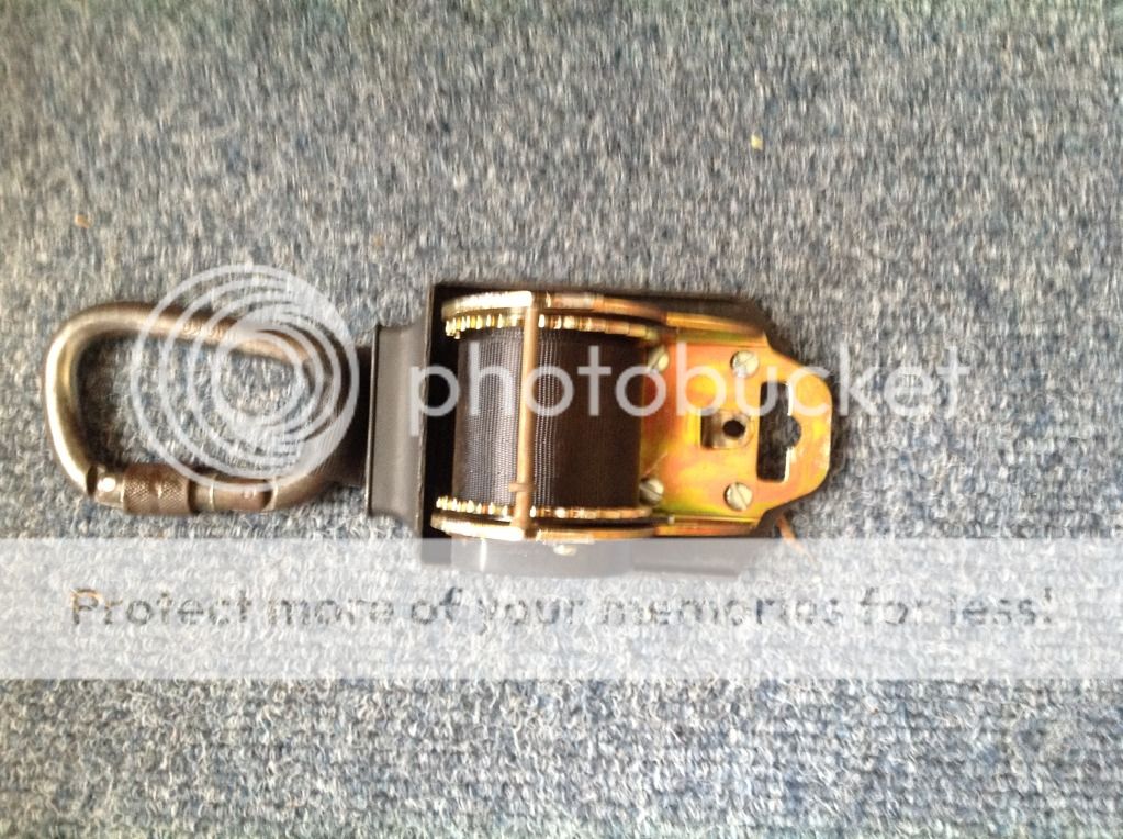

Okay guys, I knew I could do this cheap. Grainger item# 2VkN8 the self retracting logistic tiedown strap for 52 bucks should work great once I cut all the unnecessary stuff off it.
Should have a rough working prototype ready within the week I hope.
All for less than 100 bucks using my own steel locking biners.

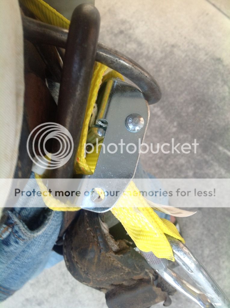

Okay, got the retraction unit delivered today, all the extraneous stuff cut off it, so it's ready to mount on one of my saddles.
Don't like the seatbelt like webbing, so I'm waiting for the cam mechanism with heavier duty webbing to be delivered so I can switch it out.
There's really nothing complicated about this project at all. In fact I'm quite sure a very lightweight retraction unit with a stamped aluminum housing and very heavy duty small spring motor is easily doable.
But I'm going to finish this one and give it a run just to see if it functions as intended in the tree.
jomoco

Must be my lucky Friday!
2,500# assembly breakage point...half what you need.
The idea is interesting..now find the right solution...have fun! I like the brainstorming.
