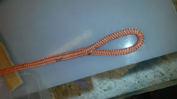

Does the eye feel a little baggy?
The tapers look a little abrupt in the throat...

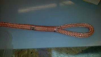

I thought that the eye did feel baggy at first. I was able to give the eye a tug and it stretched out a little and felt better. Should I keep working it, or does it look like I may have missed a step somewhere and need to restart?
I don't think it warrants a restart. Nice job!

Justin,
Nice job. Isn't it fun to make your own?

Thanks Reed, that's how I've done it but someone on another thread thought the splice should be loaded to the working load limit of the rope before stitching or whipping.
Listen to reed, as long as all the marks line up and their is no baggyness it will be fine, if it's baggy loading the splice will help it slip and can equalize the cove/core or in the other thread the brummel and bury. If you sew it up with baggyness or bunched up brummels you will load the stitching as the splice wants to seat, therefore will distort the lock stitching or whipping in a unfavorable way... but take it or leave it. If you don't believe me just try it out.
