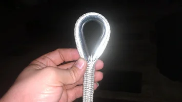

I spliced a teardrop steel thimble on one of my long lanyards and I love it.. I didn't tighten it all the way either. I left it with a little wiggle room and it works great
