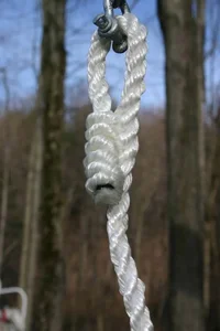

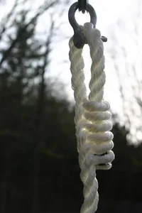

Here are a coupleof pics of a splice on a release rope for a truss hook I just bought. It has no need for strength but I still think it looks shotty.
yeh.its just to release a spring so it wont come out but it looks like crap to someone who is used to a real splice.
Strengthwise this would seem slightly leveraged/ not inline pull, with more arc/flair than necessary; giving 2 leveraged instances working against you i would think.
Security wise, the splice is not ribboned to give more surface area of grab; and the main standing line pull is not on the end/bitters directly.
Ribboning gives less leveraged flair/arc for strength and also more surface area to grab; according to Brion Toss. So in 1 move ribboning the strands before weaving back through self preserves strength and security.
i think the side by side splice, rather than inline/usual style would also similarily and negatively effect strength and security both in 1 move also.
That I agree, I get a friend to do all our splicing for us all over here. It cool just to sit there and watch it get done so professional, makes me want to learn.
Scotty
I can't remember where, but I've seen that termination before and played with it a bit. It's got more balls than you'd think.
Glen hit it right on the nail. Depending on the application, that splice could be MORE than strong enough. Judging by the line being used, I am guessing this isn't a very high-load task expected from this line.
A "proper" splice's only advantage here would be neatness, and that's reason enough!
