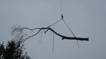

Shepherds is having them made now, 3/4 Crosby master link with the adjustable eye of up to 4 whoopies spliced in and a Crosby hook spliced into each fixed eye.
It's not perfect, but it does meet ontario regs ( no knots)

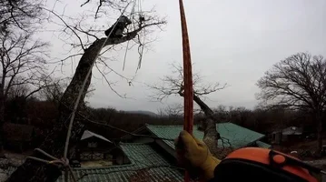

What size and kind of trees do you use 25' or 40' spider legs in? I can't figure out how I could use legs that long in 99% of my trees. Do you have any pics or anything? If trees are 120' tall I can see it but I have 50' tall trees wider than tall.
This tree was a 95 foot White Oak. The leg tied closest to me (I'm cutting) is the 40 footer. Since the limb angles up slightly, there is a bit of line dangling from the 25's, but as you can see the longest line almost full length. The rational behind such long legs is that you can leave the ball way up which makes limb walking and rigging very easy. Once the hooker sets the boom/ball, he rigs the limb and distributes the weight as he sees fit.
