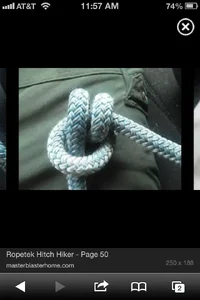

I like the hitch hiker stopper knot on my ropes and lanyard, kind of a not quite dressed double fisherman's.
Never seen one move yet.
Jon
anchor bend? pretty sure thats an anchor bend minus the last half hitch on the tail.
I misspoke, but no, not an anchor bend or a dbl fisherman's but a dbl overhand just dressed a little differently. Tie a dbl overhand and kind of roll the parts around and over one another and eventually viola! Hh stopper knot.

Whatever it's being called, I trust it for this purpose.
Jon
