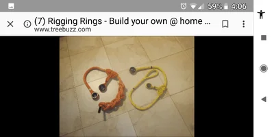

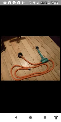

What i have coming is something like this incase it was hard to picture. Difference is, is that rings are the same size & it's rope & hitch cord. (See way down at bottom).
I actually ordered it as 28ft.. 20ft of it im planning on using to make another one, however with a large spliced eye to pass something through - pully, ring whatev.. I honestly bought it to try my hand at learning to splice otherwise i would have ordered the bare end with the large splice already.. Its something i really need to pick up & learn.. paying someone $20 everytime i don't want the downside of a knot gets freaking expensive. However.. ive heard splicing these rig rings into prussiks can be tricky..
Besides all that, just a general question here.. is there some sort of small cinching device that can be used to keep a girth hitch from releasing when not loaded? You know something that might go around the rope above & right up against the hitch? Like if i had a big dead eye & girthed it around a rigging ring.. something that will keep it from backing out or coming loose.

For what it's worth, I thought of using a petzl open on an eye splice that I already had (end of a new rope got nicked) to make a friction saver. I was informed that the petzl open may not be hard enough for the friction, and constant running rope through it. I ended up going a different route.
Speaking of different routes, could one of your rings be replaced with a quickie, carabiner, or screw link? Giving you the size difference you would need. I have a multipurpose sling, it can be used for srt redirects or a non adjustable friction saver. It uses a rock exotica pirate carabiner and a ABR #2 rigging ring. When using it as a friction saver, I can use a DMM ULTRA O to retrieve it.
Slide a rubber grommet over the loop of the girth hitch to hold it in place.

However.. will those really hold steady? I recently saw this clasp/grip type thing from petzl.. it purpose was to hold two opposing sections of rope from moving that might be wrapped around something.. I know that's wicked vauge, whatever it was used in escapes me. I know it was a very small metal contraption with two holes & a bend right in the middle... Uggh.. that's gunna drive me nuts now..haha..
Just so im not confusing the thread with whats what.. I do not have the dead eye yet where these rubber grommets would be used.. i was going to try splicing one with some of the 28ft that's coming in this friction saver were talking about. You know.. like make a 5 or 6in eye split tail out of it.

Yes i guess you could stitch it like that... wasn't aware that was ok... However, I should have been more clear with my intent.. if I'm girthing a rig style ring with a large dead eye, it's going to be because i want it temporary.. Now i say temporary as in one climb I'll use it this way & the next i may have a pulley prusik hanging through it.. that's the type of scenario i was invisioning.. BUT...I don't want any chance of that girth loosening up... You know.. some scenario where you would girth it.. hang it on your saddle, climb tree, jossle it around a bunch & then expect it to be still girthed tight.. you know not having to fiddle before installing..
Then the next climb i may want to shove jamb a pulley through it..
Again, just so no one gets confused, right now we're talking about a completely different friction saver that I want to splice out of that extra rope i have coming on the tail of the Rig Ring saver.
