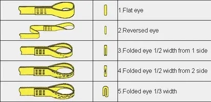

Mar 17, 2006 #1 Kevin Location Ontario, Canada Why all the different eye configurations on slings. Anyone know the purpose for each of the eye designs in the attachment? I think the folded eye is designed for lifting. Attachments 43555-slingconfiguration.webp 19.3 KB · Views: 165
Mar 17, 2006 #2 Tom Dunlap Here from the beginning Administrator Location Retired in Minneapolis #2 will allow the eye to lay flat when it is choked. If #1 is choked there will be a bit of a twist in the eye. I think that other ones add more webbing thickness in case of wear. I'm just guessing...
