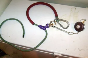

I made an adjustable retrievable redi I use for double rope but it should work the same for srt.
All it is is a chunk of spliced rope with a snap shackle on the prussic. I put some zing-it on an automatic fly reel that connects to my saddle and the other end to the release mechanism of the shackle.
