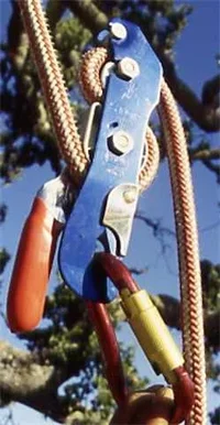

Maybe I'm old fashion but I still like the STOP when climbing on single line. Of course it works great when desending and is a little stiff when going up. But I find that if I use a microascender on the line above the stop and clip a carabiner to it then put a small pulley on the carabiner I can then climb back up the line. It is easy to put a throw-line on the microascender to help pull it up the line.
I'll do my best.
Yes the Stop is attached to my saddle and the microascender is on the line above the stop. I either run the microascender up with my hand (or pole pruner) or I pull it up the line with the throw-line that is attached to the microascender. Simple enough concept.
When you go lateral on a limb you can either move the microascender out with you or leave it alone but don't forget to bring the tail of your line with you so you can use it to take up slack on the way back in. I'm sure you've seen me demo this technique before at the expo some years back.
If it isn't stormy weather I'll shoot a shot tomorrow for you of the complete set-up. I thought I had one in my collection but can't seem to find it.

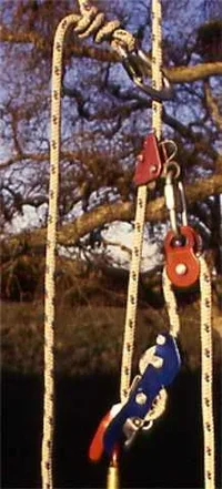

The weather outside is a disater so I found a picture from way back showing the concept . The picture should be self explanatory.
When I use a carabiner to secure the false crotch I put a throwline in the carabiner to help assist pulling up the microascender.
