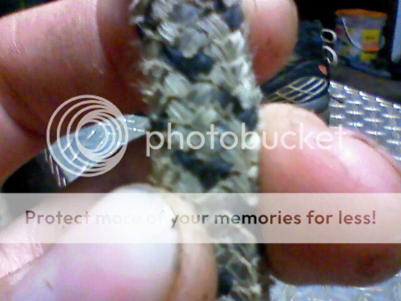

should this hitch cord should be replaced?(pics)
there is a slight bit of glazing on my 5/16 beeline cord and lots of little frays and burrs. the middle of the cord between both eyes feels alot skinnier then closest to the eyes too. should i get a new one allready?
nothing cut??? are the ends spliced? if so then it is normal for the middle to feel skinnier.
take your fingernail down it, unglaze it a bit, I would still ride it :)
reverse the way you tie it every climb too, even the wear.
It's impossible to make a sound judgement call without actually seeing the cordage. Let somebody who knows what to look for, see it. If you're asking for help, then it's time to get a replacement. Always go with your gut.

How often do you go through cords? I know I'm a lot slower than you young guys but I'm still riding one I made in January, used it almost every day and it's still fine.
It gets down to how you feel about climbing on it. If you have ANY reservations, ditch it because you need to trust your gear 100%.
Re: should this hitch cord should be replaced?(pic
The only thing I've noticed on my "older" piece of beeline, is even after switching sides, and rotating it, seems the cord has "flattened" out. Might just be my imagination though.

i use 3 times a week full 8 hour days sometimes. when i descend i go slow but sometimes i pull hard and zip. i have noticed my descents are getting jerkier and jerkier as time goes by. if i like the feel of beeline what would you recomend me? btw i have never tried 3/8's cords, i have only used 5/16's
I love BL, but I have some OP hitch cords now and they are real good, after every climb I roll my beeline like you did with play dough as a kid, it rounds it out and I feel for any mushiness.

i just wanted to make sure im not retiring my cords to early. im trying to get the most outta the cord before replacing it.
Being cost conscious is important, but not as important as retiring it too late.
Confidence is part of the equation. Newer gear may mean faster working with less nagging feeling in the back of your mind. I know where you're at with being uncertain about acceptable wear.
This can be an opportunity to try some new cords.
Spliced hitch cords are nicer, and that's what you pay for. Perhaps, try some different tied cords for economy, then after finding what works well with your climbing set-up, go back for a spliced hitch cord.
For long lowering-out at the end of a climb, you may consider a non-twisting/ hockling mechanical device or combo, like F8 system, to reduce your hitch wear on spliced cord, helping you save your dimes and dollars for that climbing saw that you're after.
had it for about 6 months now. bought it from wesspur back in February as a part of the split tail up grade becuase i needed some extra caribiners too so i said "what the heck, might as well go for it". but it has been getting stickier, your right. it was slick when new. my friend tai doman told me to try ultra tech or HRC. he said if i liked beeline either get a new beeline or try HRC which has a similar feel.
Years ago I was at a rigging talk that Don Blair taught. The inevitable question, 'When should I retire my rigging rope came up?' The best, and only answer...'The day before it breaks.'
This sounds like a smart- reply. On the surface it is of course! But, Don's point, like John has said, is that you can never have too much rope. Retire it early if there is any question.
Looking at that pic, Josh, my gut reaction is that it has a lot of life left in it.
(sorry for not responding to your PM- but this makes a good thread!)
As someone who is in the business of selling hitch cords to people, of course I wanna tell you to replace it! But honestly, if I see that in my gear bag, I'm not even close to thinking about making me a new one...
