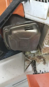

I have a 192 it doesn't have any snap getting up to speed is slow What type of gains did you notice with your muffler mod?
Try a muffler mod ; timing advance and a sharp chain ... I am available for saw upgrades ... have videos showcasing work .... email Fabz2@me.com .... after "massaging" the saw u can expect up to 40% faster cutting ... if more Performance is desired the combustion chamber can be modified and porting done
