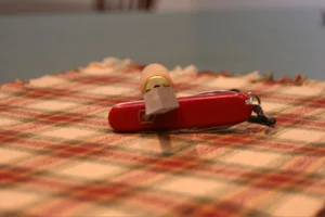

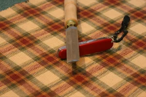

Some of the Silky blades are hardened, and can only be sharpened by a grinder. I have had good luck sharpening my saw blades, I also sharpen my woodworking handsaws blades. A use what is called a feather file, it has a narrow and fine taper profile I will attach a picture. Hope that helps.

Yes Pat, I am using the feather file ,it seems to still work fine as i'm using it on the fanno blades, I'm careful not to put to much down pressure on it. The feather files seem to keep from plugging when you use them lightly .
Do you free hand file ? I think the tough part is keeping all the angles on the tri-cut consistant.
jim454, Yes I free hand it. For consistency I file the same angle on each tooth, if that make any sense. I put the saw in a vise arranged in such a way that the filing action will be straight and level, as the blade curves I readjust the position of the blade to keep the filling action straight and level. I file all the front edge of the left side teeth, then the back edges and then that little edge on the top. Reposition the saw and do the right side teeth. I by NO means am a pro at it but I notice better cutting action after a touch-up.

Treebarber, is that feather file the same one as what can be purchased from the Sherill catalouge? I've been meaning to pick one up for myself but always seem to pass it off for whatever reason.
