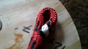

It's always that last little bit that needs a little more help getting there. This is my Yale 11.7 that is at that point right now. Looks like I need to take it to work and "help it" with a little more love, lol.

Levi, I think it is a version of Sunburst. The tracer reads "Yale 11.7 CE 6,500lbs polyester outer, nylon inner
Raj, it will be a tight eye (standard 3-1/2)
