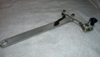

With my homemade wrench (photo above) I had some issue with it being less responsive and smooth than I wanted on the 13mm Ash but solved this when I tried contouring the two bollards to fit the radius of the rope. Made all the difference and also seems a lot kinder to the rope. Very smooth now with either a Distel or Knut or the ZigZag.

Hey guys, there are plenty of threads to post in about your combinations of cordage and rope that work well together. I am also not interested in discussing the zig zag or any mechanicals. That's really beyond the scope of what I'm getting at. I can tie hitches that work great with fatter lines. The hitch isn''t the issue. In fact, weighted ascent and descent are both great with my setups, including the 13mm lines.
The specific issue I'm attempting to address is larger lines not moving through the wrench itself in as smooth of a fashion. If you're moving through the canopy under your own power, and attempting to feed yourself slack, at some point you won't be able to get where you need to go unless you put your hand above the wrench and shove it down into your hitch. This is harder to do with fatter lines.

I understand the frustration of people taking your post in another direction than intended, talking about ropes and hitches instead of the wrench itself. However the wrench works in conjunction with the ropes and hitches and that is where you can fine tune it. In the above post you mentioned that your ascent and descent was smooth, if you modify your wrench it may alter that performance.
My suggestion would be that if your currently happy with your rope and hitch to try a mod on your wrench. Worse case scenario the modified wrench fails at height and your hitch is still there to catch you. If you do try tweaking it, make sure to share the results as someone else may benefit from it as well.
I could be wrong, but I'd suspect that you would just need the wrench to be a little wider. If that's all that's needed, some spacers and longer bolts would fix that. If you need a little more space between the pulley and pin, a machine shop should be able to mill the pulley slightly smaller.
I don't have the specs of the pulley, but there may be some replacement options available that might work. I seem to remember a pulley sheeve that slips onto a carabiner or shackle. Might be a good size?
Obviously if anything happened after alteration, singing tree could not be held responsible.
On the other hand, it really isn't that hard to build your own wrench from scratch, if you wanted to. It just wouldn't look as good, at least mine doesn't. :)
I made my own. This is working great on fat Tachyon Ash which is 13mm. Used a Distel or a Knut under it til I got the ZigZag; worked good like that too. I have a Bone now but still like this setup sometimes.View attachment 49978

I don't think I would want to make a custom RW for anyone else; there is a fine legal line between doing one for your own use and making one for another, when it involves a patented commercial product. Also there is the liability issue if it somehow failed for you. But really it is not a bad job to cobble them together yourself to experiment. Here is another I made (for smaller rope) that is mid-line attachable. Uses a quick release pin from MSC Supply Co. This took me less than two hours to make using only a woodworking bandsaw with a fine tooth blade, small drill press, and a file. In a pinch, it can be done with hand hacksaw and hand or cordless drill motor. Aluminium in various sizes is sold at many hardware stores. There are a number of possibilities for the bollards. Stacks of stainless washers the same size will let you adjust the width, and if you can find them in several diameters then you can adjust this too until you get it dialed in, whereupon you replace the washer stacks with bollards the same size. Contoured bollards make a real difference too. I made my wrenches to slide very easily, too easily in fact to engage reliably, so that is the reason for the short bungee to pull them up and ensure engagment. I have to keep an eye on these things when climbing on them in case the bungee broke, etc. but of course one needs to keep an eye on the situation anyway to tend a hitch, whatever. All this was solved for me when I saved up for one of Gordon's (Surveyor) Adjustable Bones. Get one of those and you can adjust it exactly for your own rope and weight, and the things work reliably and trouble free after that whether ascending, descending, limb walking, anything.blob.webp
