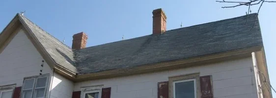

Here's the roof (there's an existing pulley out there on the R gable end ridge just inside the rightmost lightning rod, though I've never inspected it):
