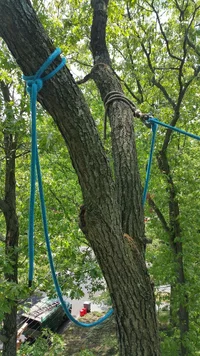

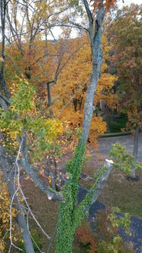

get 200' of true blue and take some $9 shackles and cut some short retired lines for slings and get to work.. The shackles work fine as long as you use multiple over head anchor points. Bend radius is too tight if used alone.. OBviously the system is to be used for light and medium rigging only...
