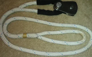

Or you can do a 5/8ths tenex eye sling with some cordura chafe sleeve on it to prevent picking. I recently spliced up a 3/4 stable braid sling with 12" eyes on both sides this way I can wrap the sling around the rigging point as many times as needed then just put the eye with the block thru the other eye. I tested it on a small tree I got here at my house and it worked out great was real snug (no slop) I know it probably won't be best for all situations but it can be useful. You could also use it to choke up on another tree to run a pulley used as a redirect or a good knotless anchor point. Especially for rookie groundies who aren't good at tying knots....

I spliced up a couple of slings like that and use them all the time. It is a real time saver.
I also take the middle of the sling and go around an anchor point and through the two eyes. Then attach block to center of sling.
Genius thinking treezybreez that's a great idea. I can also choke sling to rigging point then throwthe other eye between a crotch and then hook a block to that eye.
