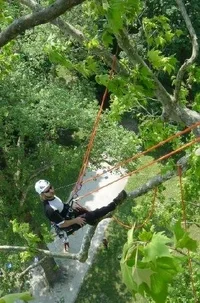

kathy, for the m redirect you unclip your lifeline(end with the splice on) thread it through the krab you unclipped it from, run it over the secondary anchor point then back to the biner and clip it back in. then to retrieve simply unclip and it will come back down to the biner.
Attached is a photo that someone else submitted to another thread here on TBz.

HA! That's a guy who took a class I taught in Italy! Nicola was his name and he is a very good climber (BTW). Thanks Mahk, I forgot I had that photo.
When I first thought of the "M" system, I was using no extra gear. Then I added the pulley on the harness. Then a second friction saver. They all react a little different and can be used for different solutions. But, I should've given it a different name.
