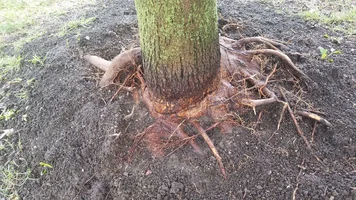

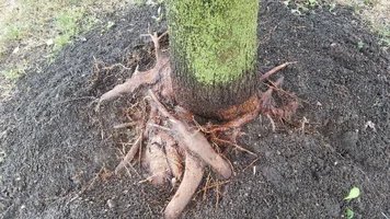

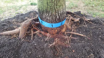

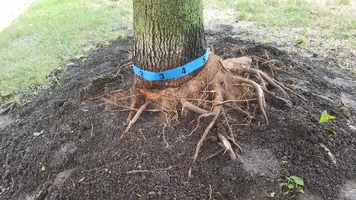

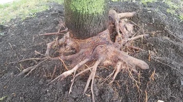

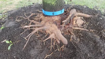

Team: any thoughts on this challenge? Approximately 15yr old Norway Maple. Also is the girdle "fused" to the trunk near #6 & #7?
