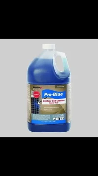

Air twice a day (morning and lunch) also put a piece of window screen over the radiator itself to keep out larger debris. When ours gets really bad we use an acid that is made for cleaning condenser coils-I can't remember the name off hand, but I'll post it when I can take a pic of the bottle. Most air guns are poop for cleaning chipper radiators, so we normally"upgrade" ours by fabricating a new longer tip out of brake line -it works way better.
