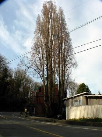

Check out these beauties. 2 young and healthy lombardy poplars. Only one way to do the job and that is with 2 lowering devices, preferably GRCS. Hobbs will work and portacrap might be OK..Guess how many outfits own all three in this podunk town!! (1 ld should be sufficient for one tree, but the one over the laurel may require using the other tree as a gin pole and drifting the loads across, with primary and secondary ld's to limit swinging.

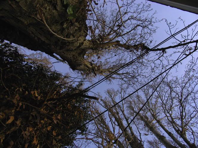

Deck is built around half the trunks. Obstacles are laurel below one tree, house, and primaries. It looks to be possible to crane out the wood from below 40-50 feet, but the crane would have to boom down as he lowers the wood to stay 10 feet from the primaries.
Only method is to tip tie each branch, suck in to spar with GRCS, butt cut (2 climbers best) lower down, gingerly drift butt out with tag line. maybe chipper winch to lay it down, but must maintain 10 feet clearance from primaries. Then, the tops have to be lowered, and the main trunk butt hitched down till it is possible to fit the crane boom in safely.
I am just in the preliminary stages of the bid. Crew size will need to be 6 or seven plus flaggers for the narrow but quiet street. Street closure required for craning. Not sure abt steep slope permitting...wife thinks hubby is crazy to remove trees, heck they may be holding up the slope. But, imagine in 30 years when the butts approach 10 feet. By then, the only way to do the job would be to remove or turn off the primaries or at least shield them...and pwr co usually refuses to do this-or charge an arm and a leg..I'd reckon the job would cost $100k in 30 yrs before accounting for inflation.
Two good things are that the trees are strong and healthy and have been thinned a bit so are easy to work in.
I have an idea of the time that the job will take, and the expenses-crane, wood removal, chip volume maybe 90 yards...what do you all think and what would you charge?
The pic has annotations.

15-20k might be a good ballpark range. Do you think lyou'll be able to tackle the both in one day? Even w/ 6-7 guys that might be a tough one. Although, with the right crane i suppose anything is possible.
Rog,
Approx how tall and wide are they, it's hard to tell from the photo...........that is some large lower trunk wood. I bet they are still sopping wet down low too. I did 2 90 footers last week and they were real wet down low and this is Nov up here in the great white north............no prob with the 50 tonne though.
They are 130-145 feet tall! Crown spread maybe 30 feet Best time to do populus is late fall and late winter when the sap is down but when it is not so cold and some sap is up to reduce brittleness, IMO...I need to look at them in the daytime..and if the client is serious, call in a crane guy to help figure out how high they can get. My guess is they could only pick some of the trunks up to maybe 15-20 feet above the primaries. Then they'd have to boom down to below the primaries (the centerpin would be appx 8 feet inside the primary) But that is all that is needed, as the upper wood can be lowered no problem, and all the brush can be GRCS'd down.
I figure 2.5-3 days total. But not sure, need to look again to see how much of each upright can be GRCS'd- will there be room to get them to the ground safely...and how many procedures are required, plus how long the topping will take. The second tree will be harder as it will need to be double tied and drifted into the first tree--at least I think so, so 2 GRCS's would be the ticket. The wood could go straight into a container. My crane expenses, thanks to Mike, could be as low as $600. Container and wood disposal, not sure, maybe $800, but could be double or triple that...
So, I reckon anything over $14-16 k might be overkill. And, if I can't get the media interested in this spectacular setting of a job, I'd be surprised. Could be some great pr!!

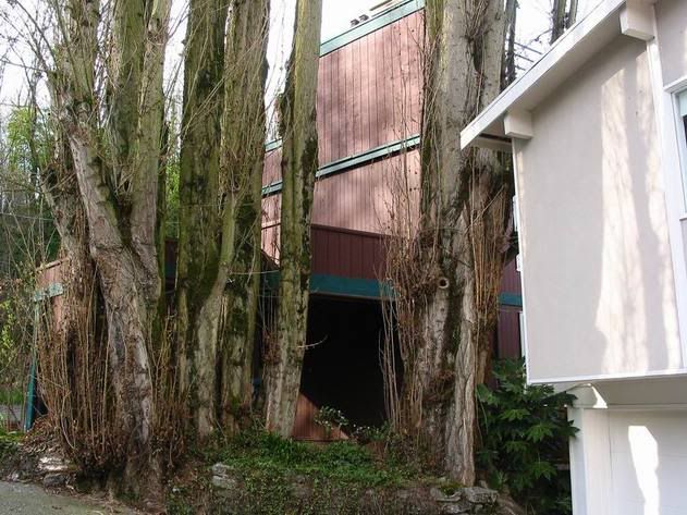

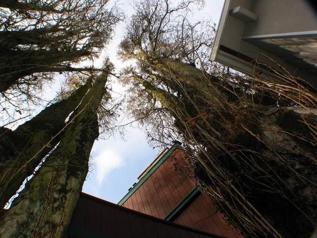

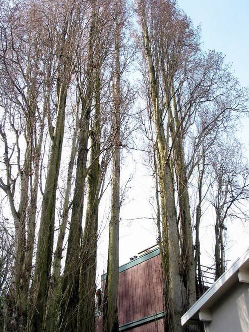

But, Scott referred me to another gnarly poplar job, these a tad smaller, at 120-135 feet, but multi leadered, declining, and smack dab on a busy street. One of them is hollow, but I think it's safe to climb. Scott was to do a few more Resistograph tests on it today. Anyhow, I'm confident we can get the trees down to 60-80 feet before we bring in a crane. There's some room to drop a lot of the tops, and the GRCS will be the tool for tip lowering lots of branches and the tops that can't be flopped, as well as some of the wood. Job is sold for about $14k including 2 stumps. Crane and wood disposal costs should be between $1800 and 2800. Customer is handling wire drops, signage, and traffic control as needed.

Yep, the GRCS will make our work easier. Minor problems are the hollow shell of one of the trees (but it has a smaller leader that is sound) and the multiple leaders which diverge from a low point. We'll plan on being tied into one and work another...as well as guy them together as needed...and, do a lot of top dumping.
I put a $2000 range on the labor and a good range on the wood disposal and crane costs as well. I love it when the customer is down with that kind of arrangement, which I think is fair to both parties. The other two bidders freaked when they heard about the decay in the trees, and figured on a 100 ton crane...which at $300 an hour, is overkill, I'm sure, and not needed. Davey looked at it, and was also intimidated..and the customer didnt even give STP a chance to bid, as, in his experience, they've been way high..hmm I don't think that is always the case...and I know they'd be up to the job, though their crane is a bit small, and they now are lacking access to a GRCS...hmmm, wonder why that is....

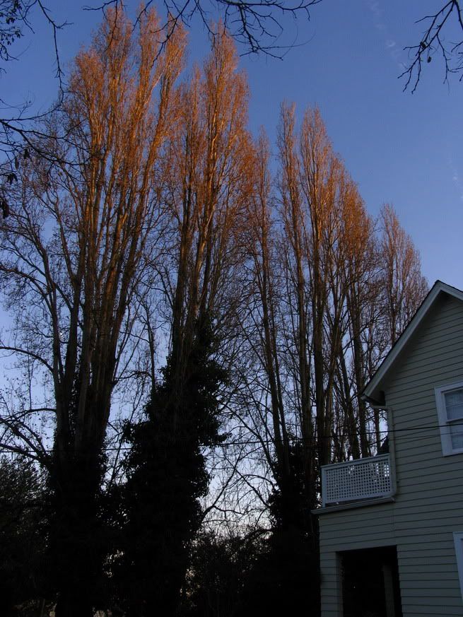

If you do drive down, Craig, do bring an ehp 200, I'd love to see it run! Too bad we'll prolly have this job done by then..but I have a potential third highly technical poplar job to hustle up, from two years ago, that I never finished the bid on. The customer had had a $25k bid, and laughed that off, said no way would they do that, they'd need a second mortgage. I think we could do the job for abt $16, but split it up into two phases. Here's pics of them from 2 yrs ago:
