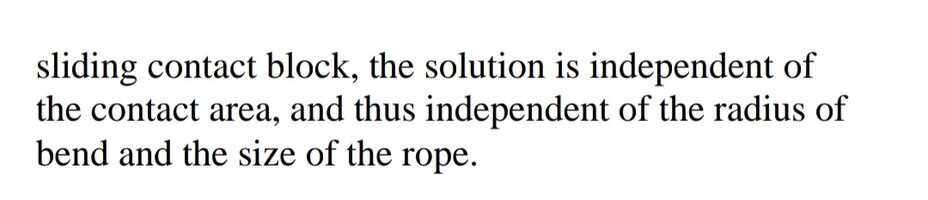

If a ring has straight, parallel sides, the rope may be in full contact with the sides when bending the rope through 180 degrees, but with (ideally) zero pressure resulting in zero friction. With a real life compressible rope, some pressure will be exerted on the sides of the ring, adding friction there while reducing friction across the round section by the same amount. It's a net zero proposition. If you add friction in one place, you reduce it in another.
A little on the capstan friction equation:
The bend radius does not affect friction.
Maybe a knife edge with a near zero contact area would provide near zero friction.

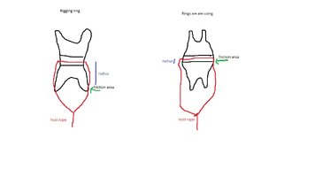

Stand by, I have to go draw a crappy diagram. What you are saying is correct. But that is not what I am talking about. Hold on a minute.
I see what you're getting at as far as the radius of where the friction is applied to the ring with regards to retarding the rotation of the ring. I was considering the rigging ring arrangent where the ring is anchored by (for lack of better terminology) the "sheave" rather than the "hole" and the ring is stationary, thus no torque. From the pictures, it appears that a recovery ring is anchored by the "hole" not the "sheave," so we were kind of apples and oranges. I think I can agree that with a rotating ring, the father from the center of rotation a braking force (friction) is applied, the greater the effect.

The one Muggs bought has straight sides. I opt to spend 4 extra dollars and get the ones that have a definitely wide area at the hole. I don't think it makes any difference, but it makes me happier.

For simple minds like me, Shadowscapes rings are used as pulleys with the rope eye being the axle/bushing. The ratio of groove diameter to axle diameter is a gain for reduction of pulley rotation friction i.e. the torque loss created at the bushing gets derated in how much it affects the moving rope by how much larger the radius out to the rope is.
So a high performance Shadowscape ring would have a larger groove diameter and a smaller doughnut hole. But that could lead to stability issues of the ring tipping sideways so there's a compromise. The At height bearing rings look a little tippy to me. Unless the doughnut hole is big (thin ring profile) like the bearing ring appears. Immutable gotchas always rear their head in designing gizmos. :)
