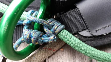

My setup includes a TM harness with the stock rope bridge adjusted to about 10" bite between the rings. I also use a Sterling 8mm RIT, tied using fisherman's knots, with about a 24" bite between the rings. I consider both rope bridges to be fully PPE.
