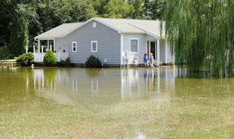

I grew up in Delaware and here is a photo that was posted in one of the online newspapers there after flooding rains today.
Notice the 220v. underground service drop on the side of the house. People just don't know better. I find this a very alarming photo.

Hope the local utility has turned the power off. I'm betting that they have as the people are sitting outside.
I'm always amazed at how people actually come outside when we have an outage and get away from the television.
Of course they come out to bitch about being without power but at least they're outside.
