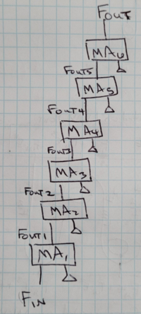

Predict the pull
If it's a 125:1 system then it should be something like 25 * 125 * .85 = 2,656.25 kg
This is saying that the overall efficiency of the 125:1 system is 85%, NOT that the efficiency of each of the three stages is 85%.
If each 5:1 stage was 94.7% efficient, then cascading 3 of them together would yield a 125:1 system that is 85% efficient overall.
If each 5:1 stage was 85% efficient, then cascading 3 of them together would yield an 125:1 system that is 61% efficient.
Edit: "cascading" = "piggybacking" = the output of one stage is the input of the next stage.
If you simply multiplied by 3 (i.e., 25kg × 0.85 × 5:1 × 3), that corresponds to an architecture of three complete 5:1 systems in parallel, with their inputs connected to a single output (load) and their input legs all connected to three separate 25kg weights, or...
(25kg × 0.85 × 5:1) + (25kg × 0.85 × 5:1) + (25kg × 0.85 × 5:1) = 318.75kg​
(These are not piggybacked)
Yeah - this is a good point. Do you aggregate losses or does the system as a whole act as the least efficient component?
that makes sense to me...and I think is what the AI was doing...you lose efficiency as you add systems (which as you point out is not how I calculated my first part)...so you calculate the 2nd stage at 85% on top of the loss of in the first stage.

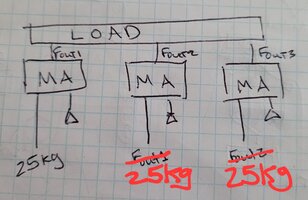

Non piggybacked:
yeah - that's what I did here:
25kg getting applied on the 3 inputs - don't know - but seems it would be something less than this - possibly the linear multiple of 3 x 5:1's = 106.25 x 3 = 318.75kg (702.21 lbs / 3.12 kN). Depends on how it's all hooked up to the load and the input / outputs work.
I thought what buggs was saying is that he's applying the 25kg at each point, and not piggybacking. I really want to see that setup IRL...I'm having trouble visualizing how you put 25kg at each input in a piggybacked (i think the term is compound complex) system.
Non piggybacked:
He's definitely cascading/piggybacking them, since not only does he say "5:1 on a 5:1 on a 5:1 on a 5:1..." and not "5:1 with a 5:1 with a 5:1..." And to confirm this, the ideal output MA for 6 cascaded/piggybacked 5:1's is indeed 15,625:1, as he noted. Six parallel 5:1's would end up being 30:1.
The exponential growth in forces along the string of piggybacked 5:1's is also why he decided to cut it down to 3 systems instead of 6.
I'm having trouble visualizing how you put 25kg at each input in a piggybacked (i think the term is compound) system.
Are you referring to this?
If I connect them in series, i.e. I take the first one and input 50 kg (110 lb), then connect another one to the first one and input 50 kg, and on and on, until I connect the last one and input a final 50 kg, what's your prediction for the final output pull?
I think he was just saying that he's consistently applying 50kg to the input leg of the entire cascaded system as he subsequently adds stages.
Yes...
Yes - that's what I understood, but the 50kg at each input is what has been throwing me.
That makes total sense to me - which means the input force is 50kg (or 25kg in the 125:1 system). Perhaps it's a misunderstanding (on my part) of the detail in how he's doing the setup of the systems and not relevant to the output force of the system. (y)
Yes...
I'll letcha hold a dollar if what he was originally envisioning is not like this (except 3 cascaded systems instead of 6)...
Each system is a 5:1 and is connected to an anchor. All of them could possibly be connected to a rigging plate which is then connected to an anchor, or something along those lines. But, whatever the case, each one's input comes from the stage before, and each one's output goes to the next stage's input. Fin = 25kg.
updating with 0.614 % (compounded losses)
25 * 125 * .614 = 1918.75kg ( 4231.3 lbs / 18.81 kN )
100%. Agree. From post #52:
output mass = (input mass) × (effective MA)
(input mass) × (MA_ideal × efficiency)​
[[[25kg × [5:1 × 0.85]] × [5:1 × 0.85]] × [5:1 × 0.85]] = 25kg × [5:1 × 0.85]^3 = 1919.1kg
