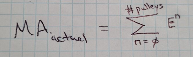

The more general form for this architecture of mechanical advantage arrangement - meaning a simple system, non-piggybacked - would be expressed as...
So with a pulley efficiency of 90% (0.9), the final MA is 4.0951:1; my earlier, *profoundly* incorrect method of calculating final MA yielded 3.3:1. Samsonite...I was way off.

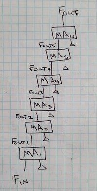

In the 4th system - "homemade thing with micropulleys and rigging plates" - back-calculating from the measured 4.33:1 MA yields ~93% for each pulley's efficiency. That is more believable, but still surprising imo when compared against some of the "presentable"/streamlined systems! Really figured the rope-on-rope contact in the system would impact the overall efficiency more negatively. Pretty cool result though.
So, redoing that earlier estimate for the final MA of all 6 cascaded systems (model below) - assuming 90% pulley efficiency for all pulleys - I get 4.0951^6, or ~4,716:1, versus your ideal of 5^6 = 15,625:1.
And, referencing the diagram below for the rationale behind combining your individual MA measurements by multiplying all six systems together, it looks line the final MA is somewhere in the neighborhood of 7,584:1. Using the above equations to back-calculate the average pulley efficiency for all 24 pulleys in the cascaded system, it appears that they are on average 94% efficient! Obv. some are more, some are less, but the average amongst your collection is approx. 94%.
Model used for calculating an estimate for the cascaded system's overall MA (triangle symbol represents an anchor)...
Thanks for bearing with me. I went through all this to try and explain what's happening to myself. I've never sat down and done it with this level of thoroughness before, and it may *still* have errors, but it's at least more believable than my initial junk a couple pages back.

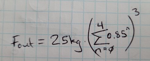

With the cascaded/piggybacked system, treating each entire 5:1 system as 85% efficient - as the AI seems to be doing - I arrive at 1,919.1kg of output force from 25kg input force. 25kg×(0.85×5:1)^3 = 1,919.1kg; close to its answer in the table, but I'd think it should have the ability to get closer. Could be that it's including some factor I'm not, though.
Redoing the three cascaded 5:1 systems with each pulley being 85% efficient (versus each system), I arrive at 1,275kg output with 25kg input.

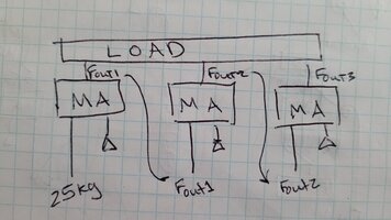

So this is the system you intended to have it calculate?
...and not this (but with 3 stages instead of 6)?
It's wild - the AI's decimal places are still off and, in my opinion, its explanation is kinda all over the place. I actually think for at least one of those "stages", it's using an equation for a non-ideal 2:1. Strange. It seems confused.
Edit: To be a little more explicit, the second diagram is 6 systems being cascaded or "piggybacked" to one another. The math for 3 cascaded systems each having 85% efficiency would work out in expanded/verbose form as such:
Fout1= (Fin) × (MA1 ideal) × (efficiency) = 25kg × 5:1 × 0.85 = 106.25kg​
Plugging Fout1 in as the input to MA2...​
Fout2 = (Fout1) × (MA2 ideal) × (efficiency) = 106.25kg × 5:1 × 0.85 = 451.6kg​
Plugging Fout2 in as the input to MA3...​
Fout3 = (Fout2) × (MA3 ideal) × (efficiency) = 451.6kg × 5:1 × 0.85 = 1919.1kg​
