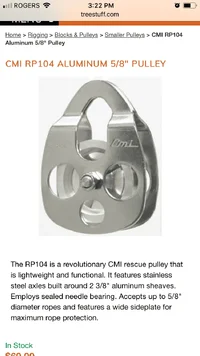

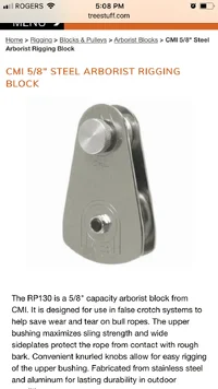

Not trying to pick apart this new pulley it looks great. But what makes it so much better and worth the extra cash over this comparable com pulley.
I know they’re different but being on the cmi now and looking what’s the reason to go for this upgrade?
A quick look shows almost double the breaking strength (16000lb vs 30000lb) , a larger rope diameter capacity (5/8 vs 3/4), a swiveling attachment point (unless you've used one you don't really appreciate just how nice that is), you can put the rope into and out of the pulley WITH OUT disconnecting it from it's anchor point (which is awesome to not have something extra to drop), and it has a tab on it to mind a progress capture prussik which is absent on the cmi pulley
whether it's worth the price difference is up to you (me personally i'm not sold on it, I'm content with the smaller omni blocks for the time being)
