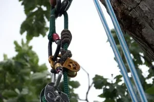

i am one happy climber at this date and time in space.
I have done two climbs with this and find that the setup in the picture working well for me.
I have to, as they say, tweet a few thing, the lenght of the cord (bluecord), the placement on my running or UP rope. as you see it is a little, long. i see that if i shorten that cord and move it down a bit it works differently.
Right now i shorten the cord by adding a wrap. I will trim to the best lenght in a few more climbs.
HOPE is that this weekend in KY - i get a little bit more advise, which i thank you all for.
THANK TO ALL for your input on this - you all are just so great to me.
jz
