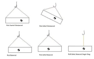

I stand by what I said, if you put a single sling precisely above the center of gravity the pick will not move at all and as for the original diagrams no matter how many slings you have on the load if you set it down unevenly on a load the slings on that side will come slack and the load will roll.
Once again the only thing that makes a load stable is having the hook directly over the center of gravity, for example imagine a load with a hundred slings on it but the hook is closer to one side of the pick than the other( not over the C of G) then when the pick is lifted the load will move until the C of G is under the hook.

if an object can rotate around a point ie: a hook then it will always move so the C of G is under the hook.
go out to your yard, find a solid log and play with it for a while if you can possibly prove me wrong, post the pics and I will explain the forces for you.
For those that don't know what C of G is, its the center of gravity, the point of an object where the weight is balanced.
For example if you have a log which is solid on one end and hollow on the other the C of G will be closer to the solid end.
its not my opinion, its the laws of physics. <font color="purple"> </font>

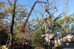

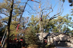

Every job &amp; every pick is at least minutely different. Sometimes i like to stand up picks with a sling or 2. Sometimes i like to spider leg 1/2 of a decent size tree &amp; bomb it out in 1 pick. Sometimes TiersonB's Rig'em &amp; Roll can't be beat!
