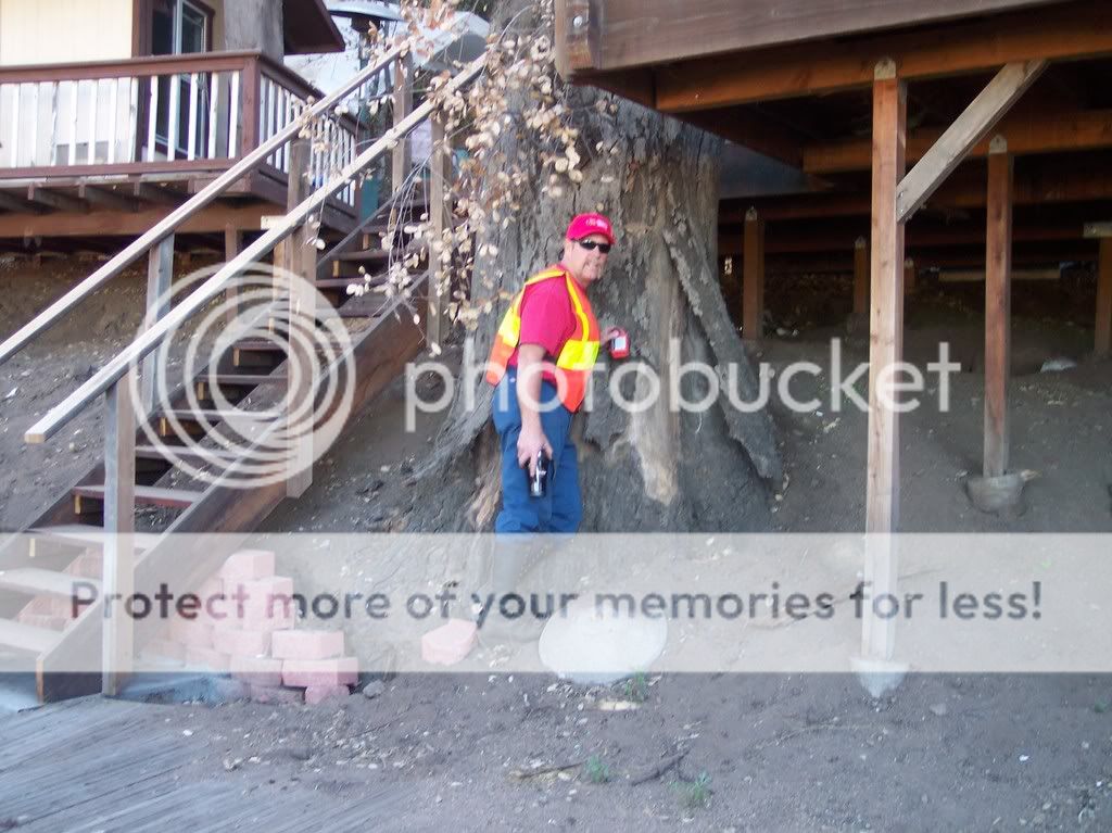

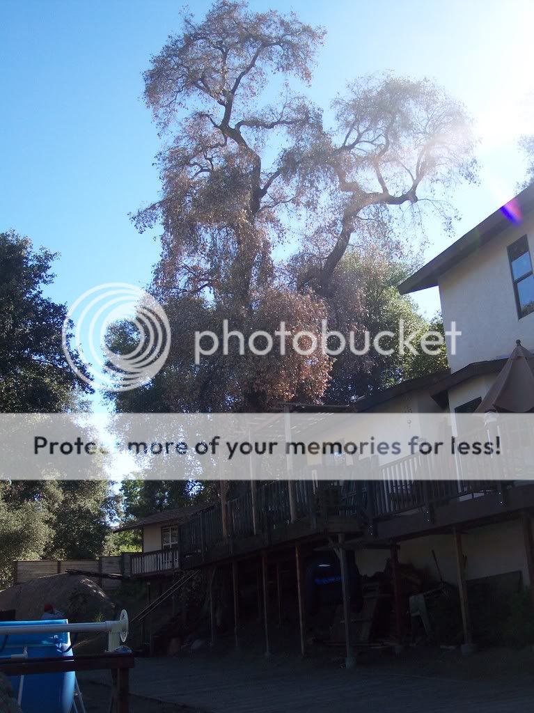

One of the recent crane removals I did here in Descanso was a dead hollow oak with a serious lean over a house. I used a series of steel and nylon chokers to ensure a relatively balanced removal of an equal number of limbs off each side of the tree, up to 8 limbs per pick, with me staying attached to the crane on a totally separate ball and hook from the rigging hook. The crane was a grove 90 ton hydro.
I have pics of the hollow lower trunk that prove my staying with the crane was a very good idea, and I must say that ANSI Z133 recognizing this need and allowing it into their standards was an excellent move as well, on their part.
Cranes can make removals so much easier faster and safer in this biz that companies without them have very little chance of competing against you price wise.
That hollow oak in descanso was a true widowmaker in waiting, and even though I thought I had anticipated just about everything on that stately old monster, it still had a big surprise just waiting to buzz and bite me about half way down!
