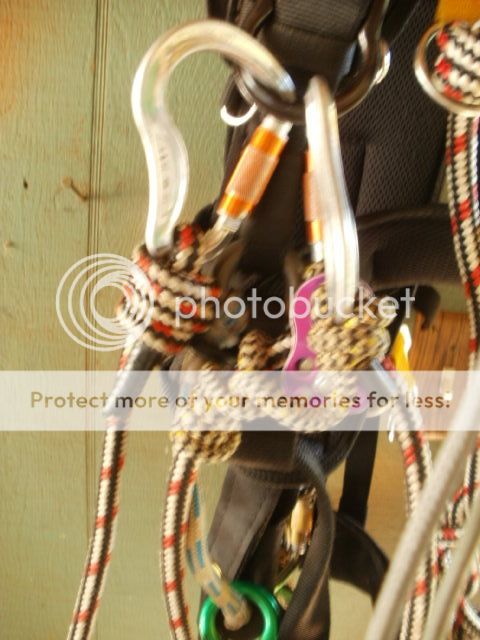

I have been using this setup for quite a while now and I can not say enough good stuff about it.

Well I am a guy that tries to mix things up. I have made a good few lanyards and even bought a CE lanyard ( which I did not like at all, dismantled it and most in my junk box except the shiny green pinto which ain't so shiny no more and I gave away the thimble and biners ). I really don't like DMM biners except the revolvers. Rock Exotica and Petzl ovals for me. Well I started with gibbs ascender and then moved to prussic pulley with micro mouse. That has now evolved to the pinto prussic combo and any half inch 12' line with the aluminium snap biner. This set-up works for me down here. I also have some velocity lanyards set-up in the same way that I use when I need a change. Here is a pic, one on the TM and one on the Sequoia. No offence to anyone liking the CE lanyard it just was not my thing.
