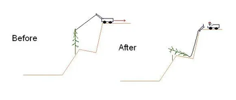

A buddy of mine was pulling an old fir down with his prentice loader last week. The tree was down in a hole and was hard to see. Well when it came down there wasn't enough slack in the winch line, when the tree hit the ground it tore the booms off at their point of attachment. The boom twisted as it came off and stabbed thru the operators cab and peeled the entire cab off over his head .The faller watched the booms come over the bank and the cab cartwheeled down the slope a good 60'. It took all the rest of the day to pick up all the pieces with the skidder and wheel loader and load them onto a low boy. ( hell of an expensive day)
In 1 second flat the booms and cab were gone. Leaving the operator on a seat hanging over the controlls .Fortunately the seat wasn't latched stationary, it tipped foreward as the cab left the super structure. The operator only suffered minor cuts to his ear. The prentice will cost $30,000. to repair ourselves. Fortunately we have lots of good old mechanicaly inclined boys around here to help out. It would a cost more for a shop to do...Just happy the operator didnt get killed.
That's about how I pictured it in my mind too.
